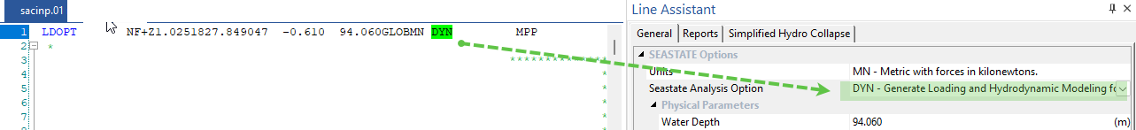

1. Enable Marine Growth in Seastate
Run Seastate with the DYN option specified in columns 56–58 of the LDOPT line. This step updates hydrodynamic properties and generates a structural data file (.oci) with marine growth applied.

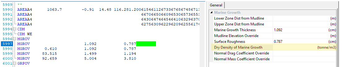

By default, SACS assumes marine growth is neutrally buoyant (density = water density).
If the marine growth density field (columns 49–56) is left blank, the weight and buoyancy cancel each other out, and no additional weight is applied.

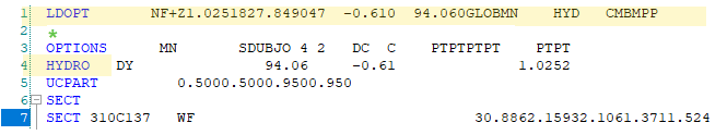

If you want to include the marine growth weight in the calculation, do the following:
a) Select the 'DYN' option in columns 56-58 in the LDOPT line.
b) Run Seastate to output the seastate OCI file. The seaoci forces were reduced by taking into account the DELGRP, DELJNT, MEMOV, and GRPOV.

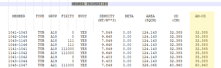

d) Run Dynamic - Extract Mode Shape Analysis. Use seaoci from the seastate analysis as the input and you will see below changes in the dynlst:

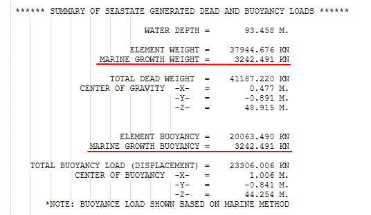

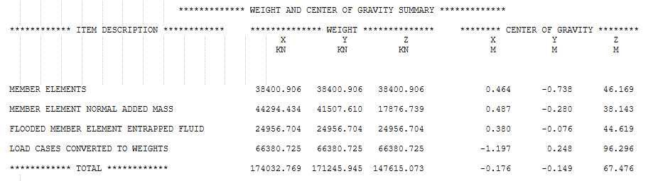

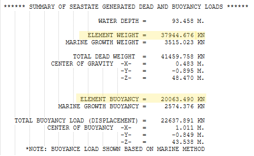

1. Seastate run:

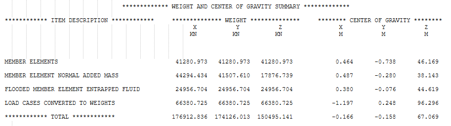

2. Dynpac run including marine growth without 1.075 factor

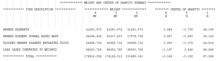

3. Dynpac run including marine growth with 1.075 factor
Element weight (seastate) = 37944kN
Element weight + marine growth (dynpac) = 38400.906kN
(Element weight + marine growth) x 1.075 = 41280.973kN
