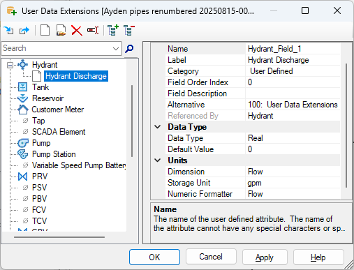

What if I want to color code or annotate on the hydrant discharge? (predicted flow)
  1. Create a hydrant User Data Extension (UDX) with the "real" data type:
  2. Open the Flushing Area Summary table from within the flushing tool and click the button at the top to export to CSV
  3. Edit the CSV (in Excel for example) so that you only have columns for the Element (label) and the "predicted flow" (hydrant discharge)
  4. Set up a connection to the Excel file using ModelBuilder. Select the Element (hydrant label) column from the spreadsheet, for the Key field, and map the predicted flow column to the user data extension you had created.
  5. Color code or annotate on the user data extension.
