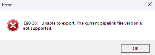

The following appeared when using AutoPIPE:
E90-36: Unable to export. The current pipelink file version is not supported.
Why and how to avoid?
As the message states, the current pipelink file version is not supported.
Possible workarounds
    1. Known issues, Export to STAAD fails if model name exceeds 43 characters (1720474), to be fixed in AutoPIPE 25 update 1.
