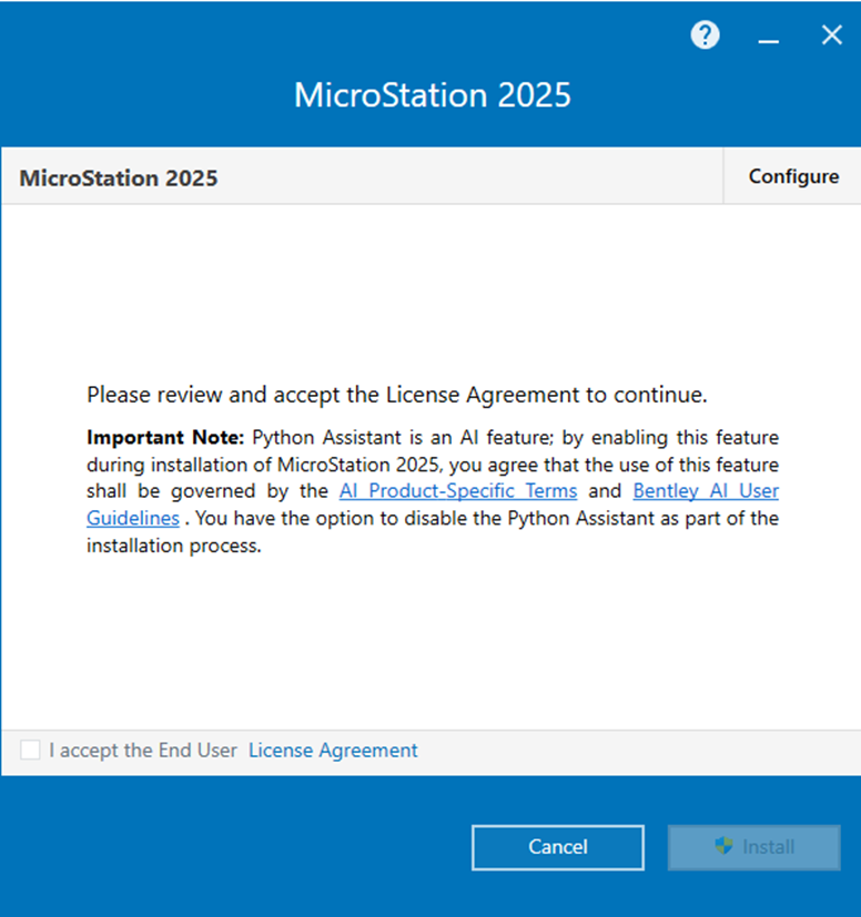

What do I need to do before using Python Assistant?
You must review and accept the License Agreement during installation. Enabling Python Assistant means you agree to the AI Product-Specific Terms and Bentley AI User Guidelines, both of which are linked during installation and available online.

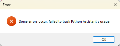

What should I do if I encounter an error tracking Python Assistant's usage in MicroStation?
If you see an error indicating that Python Assistant's usage tracking has failed, the recommended solution is to repair or re-install the product. For best results, it's advisable to create a Deployment Image and perform the installation using Administrator privileges. This ensures all components are properly configured and helps prevent similar issues.
Error:
Recommendations:
  1. Backup the product "prefs". Copy to a new folder name, like: "prefs-backup"
    • Open Windows Explorer and navigate to:
      %LocalAppData%\Bentley\MicroStation\25.0.0\prefs\
  2. Re-install the product using Administrator privileges and/or Deployment Image

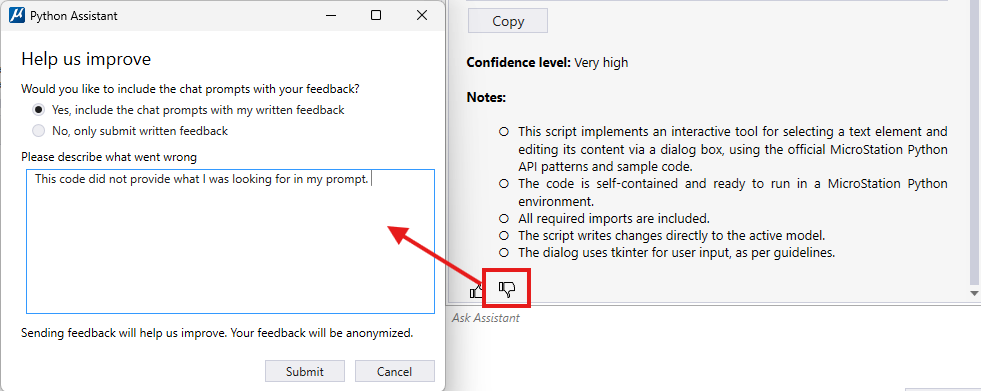

Is any of my data sent to Bentley?
No data is sent unless you explicitly choose to submit feedback by clicking the thumbs-down button after receiving an answer. In that case, only the prompt and your comment are sent—no code or design data is transmitted or retained.

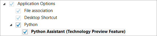

How can I choose whether to install Python Assistant during MicroStation installation?
Python Assistant is included as an optional component during the installation of MicroStation. If you prefer not to install it, simply uncheck the Python Assistant (Technology Preview) checkbox on the Features page during the installation process.
