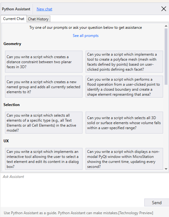

Python Assistant is part of the Python Editor dialog and can be accessed from the Utilities tab of either the Drawing or Modelling Ribbon as seen below.

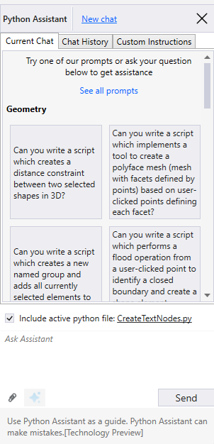

Python Assistant Dialog
Python Assistant dialog offers a straightforward interface where you can start new prompts, access existing ones, and request Python code generation based on your input.
Python Assistant has following options:
Opens a New Chat.
Opens the current chat section.
Note: You can use the prompts suggested by Python Assistant for your reference.
Opens the chat history.
Add/List of (optional) Custom Agent Instructions improving output quality of responses.
Allows you to write a prompt.
Upload a .txt file for your Python AI Assistant to read and use in sample code generation.
Example: a file with x, y, z coordinates to generate code that places cell elements at those locations.
Allows you to send the prompt to the Python Assistant.
