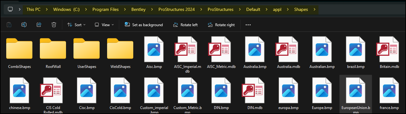

2. Now, please go to the below path where Shape database files are located in ProStructures CONNECT Edition or 202x and make a backup copy of these files below replacing.
Path: C:\Program Files\Bentley\ProStructures 2024\ProStructures\Default\appl\Shapes
3. After making backup, please paste the shape database files in the above location.
4. Restart the ProStructures (if running) to take effect of this operation.
