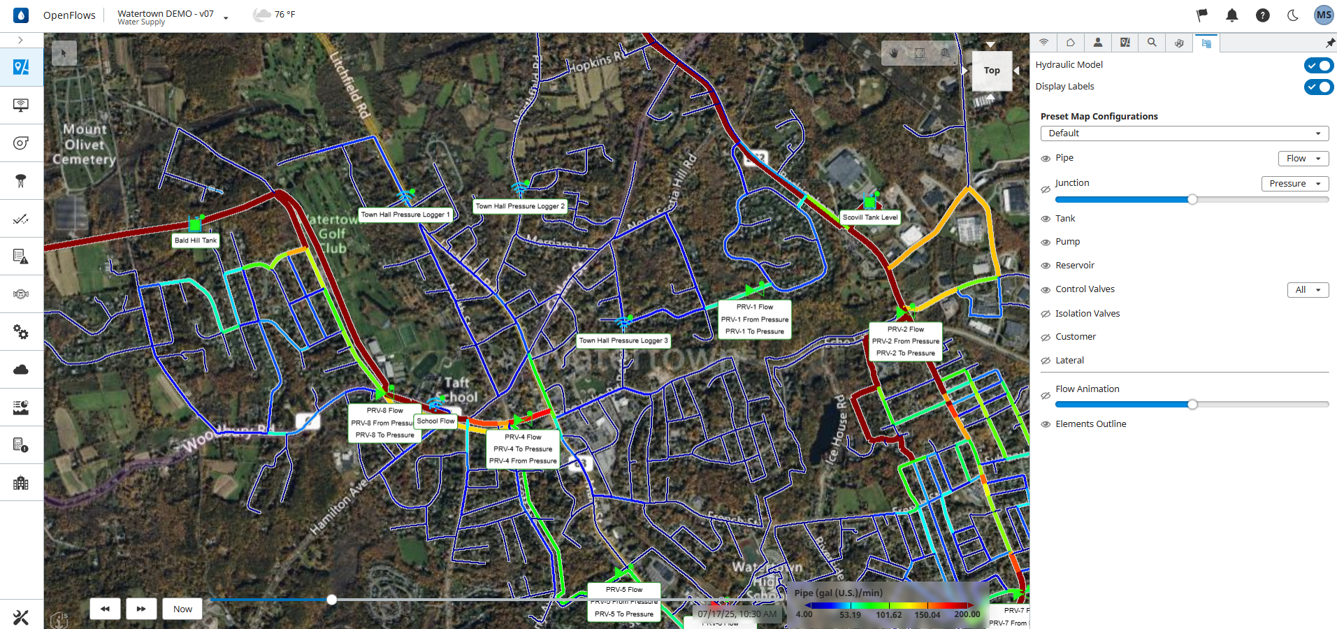

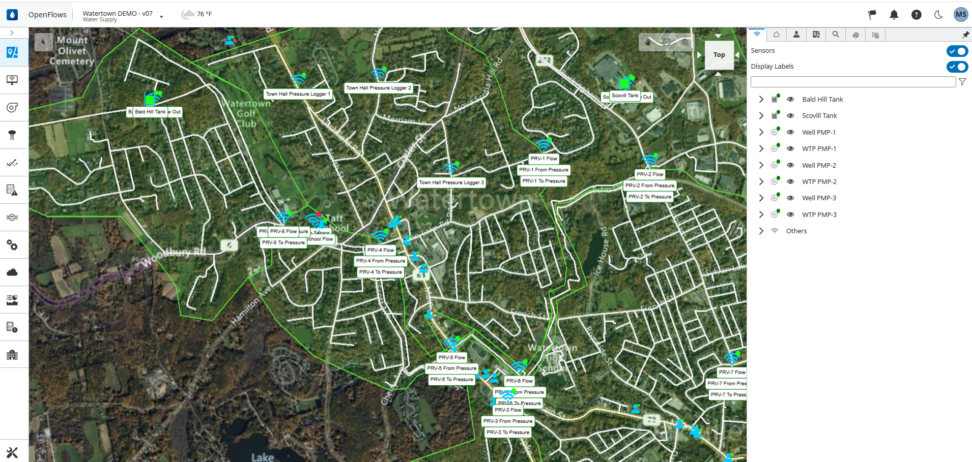

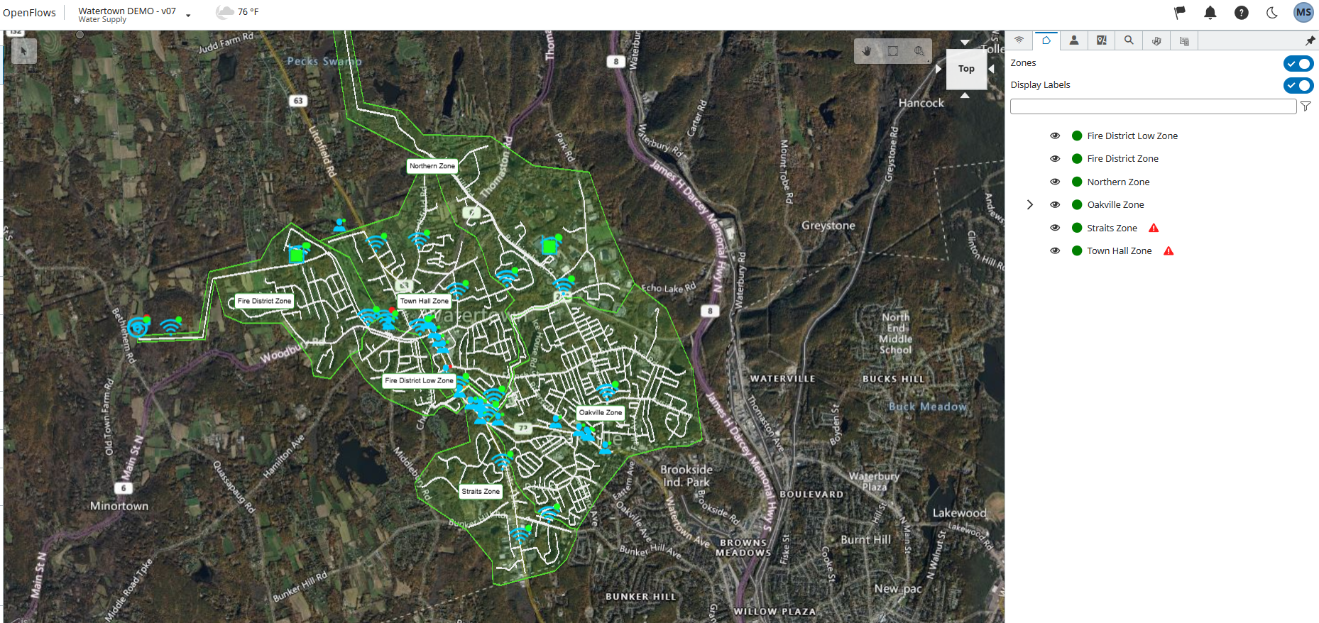

Display labels on map
When accessing the Map dashboard, the user can now turn on the display labels for sensors, zones, large customers and for the hydraulic model elements which are associated with the sensors. The option to turn on labels is available from the side widget, for each one of the tabs (sensors, zones, large customers, hydraulic model). By default this option will be off.
Figure 1 - Displaying labels for sensors
Figure 2 - Displaying labels for zones
Figure 3 - Displaying labels for hydraulic model elements associated with sensors

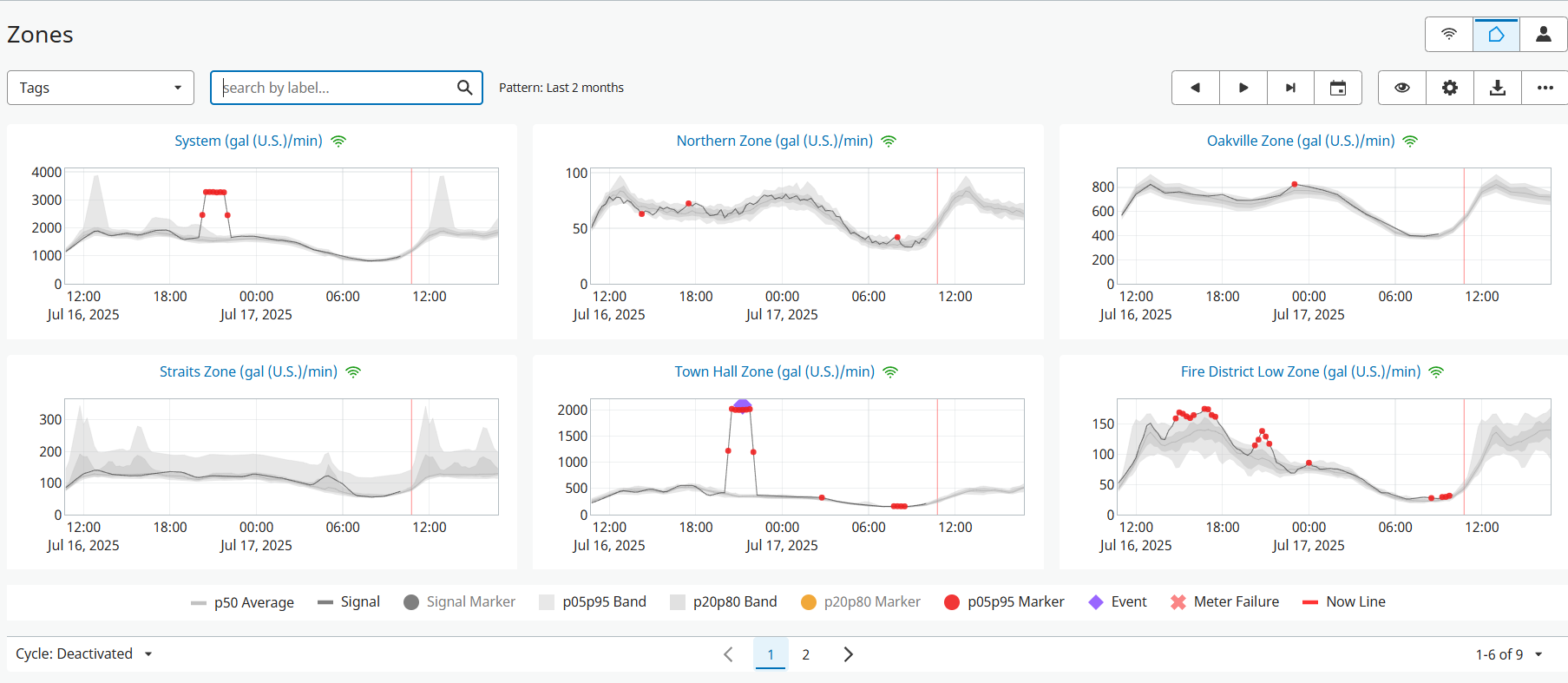

Graphs Overview - automatically adapt to the registration frequency
The Sensors and Zones overview graphs were previously automatically displayed based on a 15 min time step. However there might exist in some cases some sensors which the registration frequency is higher than 15 minutes (for example 1 hour) and for those cases the solution automatically displays the graphs based on the 1 hour time step. The sensor registration frequency is defined by the user in the administration >> sensors and administration >> smart meters.
Figure 4 - Zone graphs automatically display based on the sensor registration frequency defined by the user.
