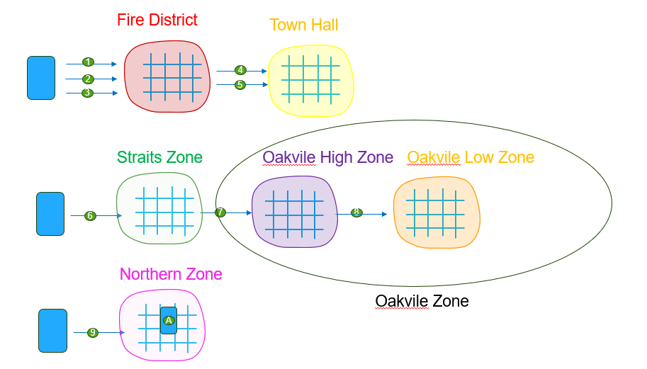

Zones should correspond to isolated distribution network areas of the system, surrounded by closed valves and where all inflows and outflows (if exist) must be measured. Zones can include for example DMA (District Metered Areas), pressure zones or operational zones. The zone polygons definition should match the zone net flow balance (the final balance between all inflows and outflows), where the net flow corresponds to the total water consumption and losses inside the zone. It is very important to assure the zone definition is correct as this will be used in WaterSight to potentially trigger events and calculate water balances and water losses.
Zones Schemes and Zones Balances
As previously mentioned, it is very important to assure that the zones polygons defined and uploaded in the Admin >> GIS page matches the real definition of the inflows and outflow sensors. If needed, update/change the zone accordingly.
One task that can help defining zones balance (inflows and outflows) and therefore the zones polygons is through the creation of zones schemes, such as those represented below.
Zones should be defined based on the inflows and outflows locations (green circles above). For the example above, the zones balance configuration would be the following:

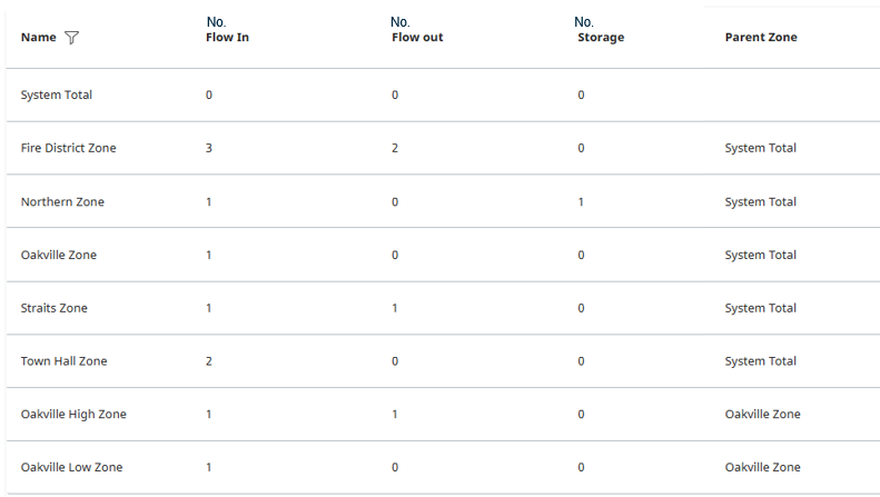

In WaterSight, the zones balance would be configured in the Admin >> Zones page, as shown below:

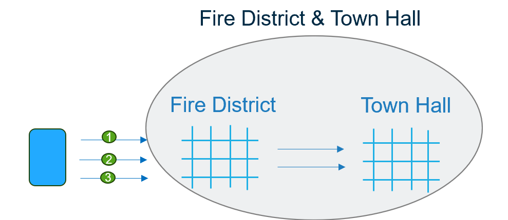

In case sensors 4 and 5 (represented in image above) do not exist or are not working, then the new zone should be a combination of Fire District and Town Hall as per example below:

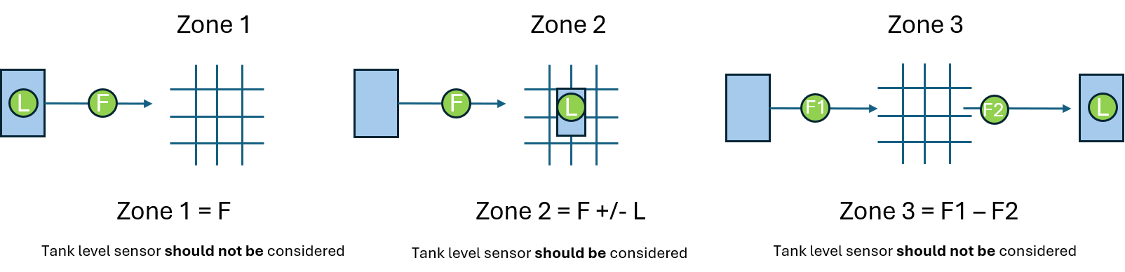

Storage sensors should only be considered for the zones balance in case the tank is located inside the zone and does not have any flow measurement associated with. This means that the tank level sensor needs to be located downstream the inflow sensor and upstream the outflow sensors, otherwise it should not be considered as storage for the zone. Some examples below (L = Level sensor; F = flow sensor):

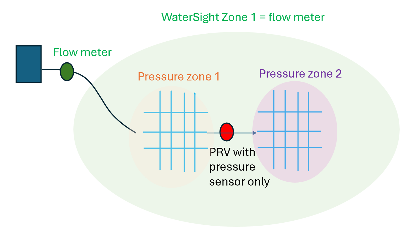

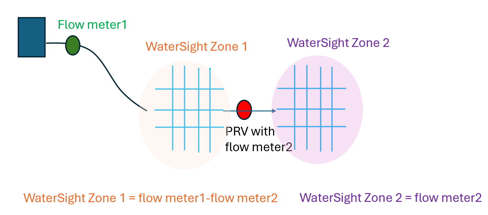

I have the system divided into several pressure zones, but not all have flow measurements. What should I do?
The concept of zones in WaterSight is used to calculate the water balances, for the alerting system and leak geolocation. And for this to work properly and results to be accurate, it is required that these zones are flow monitored. Therefore zones need to correspond to isolated distribution network areas of the system, surrounded by closed valves and where all inflows and outflows (if exist) must be measured, as explained above.
In this case you will need to redefine your zones boundaries to match the flow measurement points. Two different examples about how to define the WaterSight zones are show below:
Case 1
Case 2
