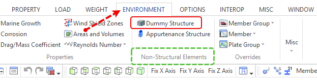

How to define dummy and appurtenance structures in Precede?

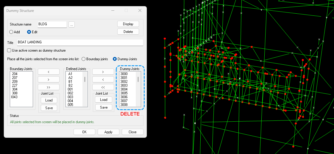

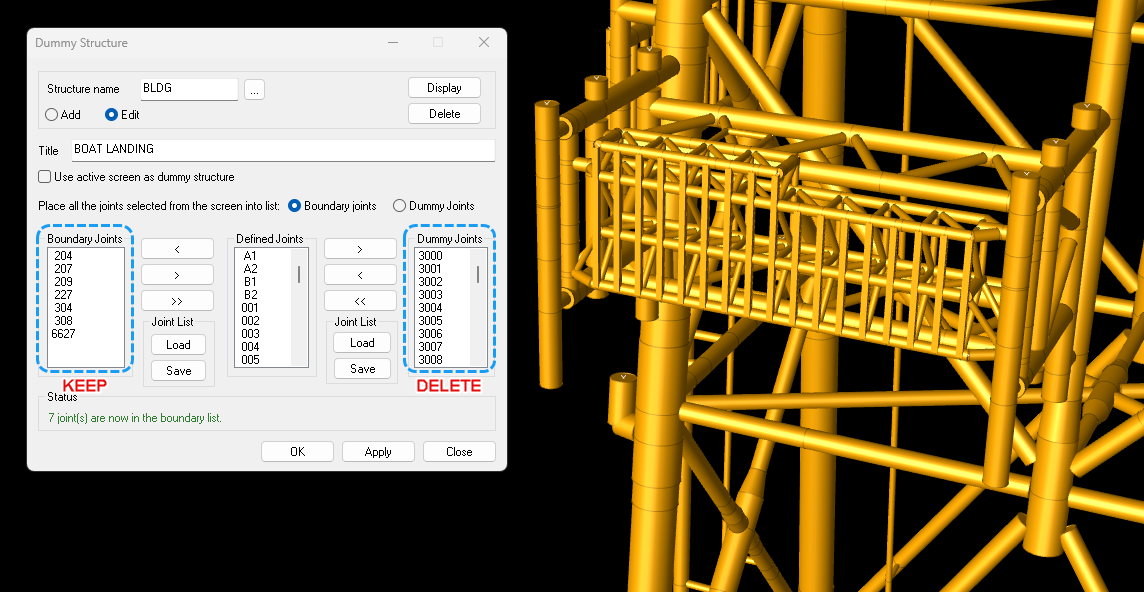

DUMMY STRUCTURES

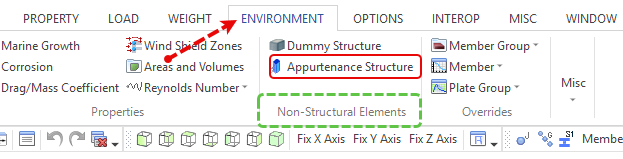

In Precede, go to the Environment tab > Non-Structural Elements > Dummy Structure

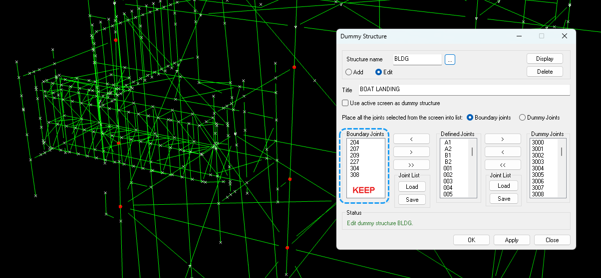

In the Dummy Structure definition,
The Boundary Joints contain a list of joints that connect the dummy structure to the rest of the structure.
The Dummy Joints contains a list of joints that lie solely within the dummy structure.
If you are looking at Datagen, the joints will be listed under KEEP and DELETE lines.

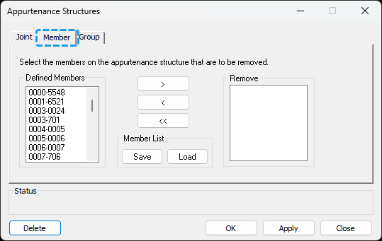

APPURTENANCE STRUCTURES
In Precede, go to the Environment tab > Non-Structural Elements > Appurtenance Structure
In the Appurtenance Structure definition,
For the appurtenance structure definition, we are going to define DELJNT (delete joints), DELMEM (delete members) or DELGRP (delete group).

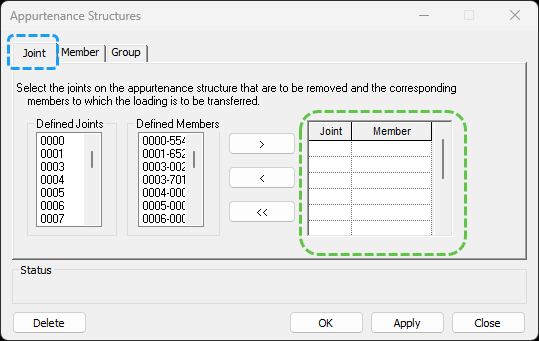

Under the Joint Tab,
The 'Joint' and 'Member' table contains a list of the joints to be deleted and the corresponding members that will receive the joint loads.
Under the Member tab,
The 'Remove' list contains all members to be removed.

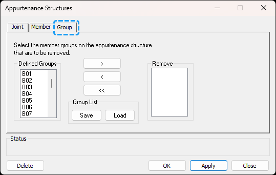

Under the Group tab,
The 'Remove' list contains all member groups to be removed.
