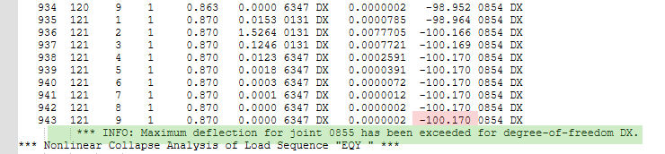

*** INFO: Maximum deflection for joint XXXX has been exceeded for degree-of-freedom DX
Questions:
The pushover analysis stops since the Maximum displacement reaches the user-defined maximum value = 100inch.
However, this joint is attached to a member that is assigned to GRPELA and GRPSEG in the collapse input file.
The member was also assigned MEMELA and MEMSEG, according to Section 4.5 of the Collapse Advanced Manual.
Is there an available approach to prevent the joint from causing the analysis to converge before the primary plastic elements?
