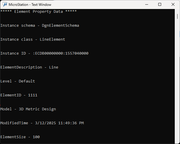

Create a new DGN file and draw a Line and Circle element. Retrieve the Element ID of the Line element from the Properties dialog and set it in the code as elementId = 1111, where 1111 is the Element ID.
Running the script displays the ECProperty, ECPropertyValue in the MicroStation Text Window.
Test the output of the Circle element by getting and setting its Element ID.
