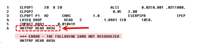

I received the below error mentioning that the MATPRP HEAD card cannot be recognized. How can I resolve this?

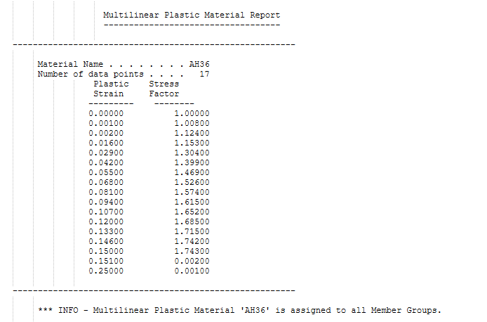

MATPRP PLAS - to define the post-yield behavior of the material

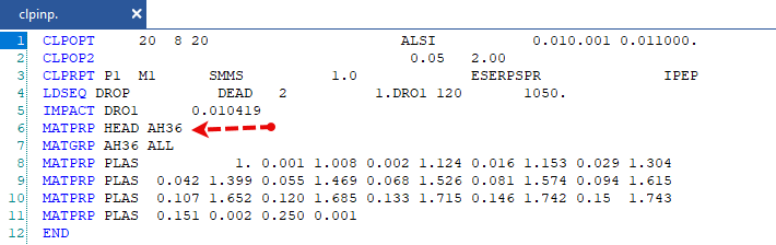

The correct input line should be defined as follows:
The MATPRP HEAD line should come first before MATGRP line.
The MATGRP lines are used to assign the AH36 material model to X different member groups and followed by several MATPRP PLAS lines to define the material model for AH36.
The input needs to be corrected as shown in the sample.
