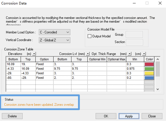

Question
Why
does it show overlap when defining corrosion

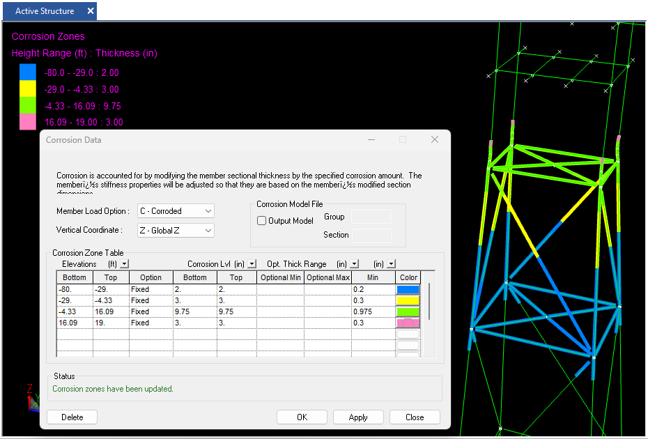

Answer
Defining corrosion zones should start from the bottom elevation to the top. Example as below:
