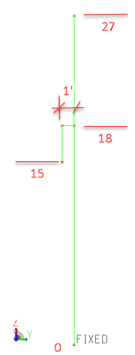

Let us walk through a simple model to understand how the dummy structure and delete joint options work in SACS.
The geometry is developed in such a way that the base elevation is 0. Corresponding elevations are shown in the below snap.

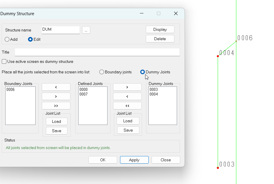

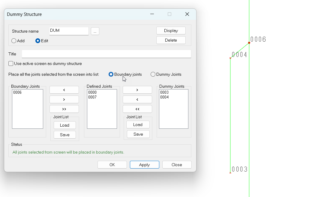

While defining the dummy element, SACS gives 2 options of joint selection.
  1. Boundary joints: the boundary joints refer to the connection of dummy member with the main structural component. This will be designated as “KEEP” in the DUMMY command in datagen.
  1. Dummy joints: And the dummy joints refer to the joints which form the dummy element. These joints will be designated as “DELETE” in the DUMMY command in datagen.

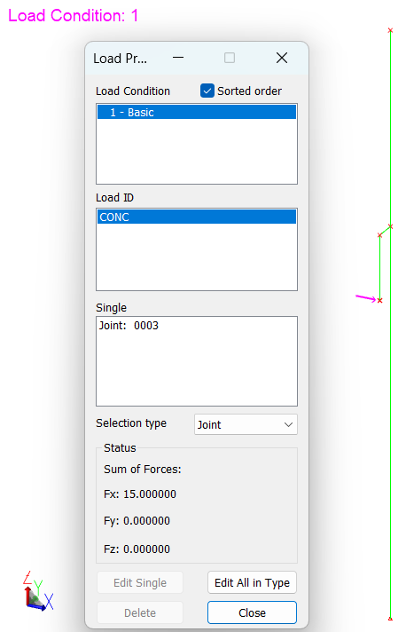

Let us apply a concentrated load on the edge of the dummy structure as shown below.

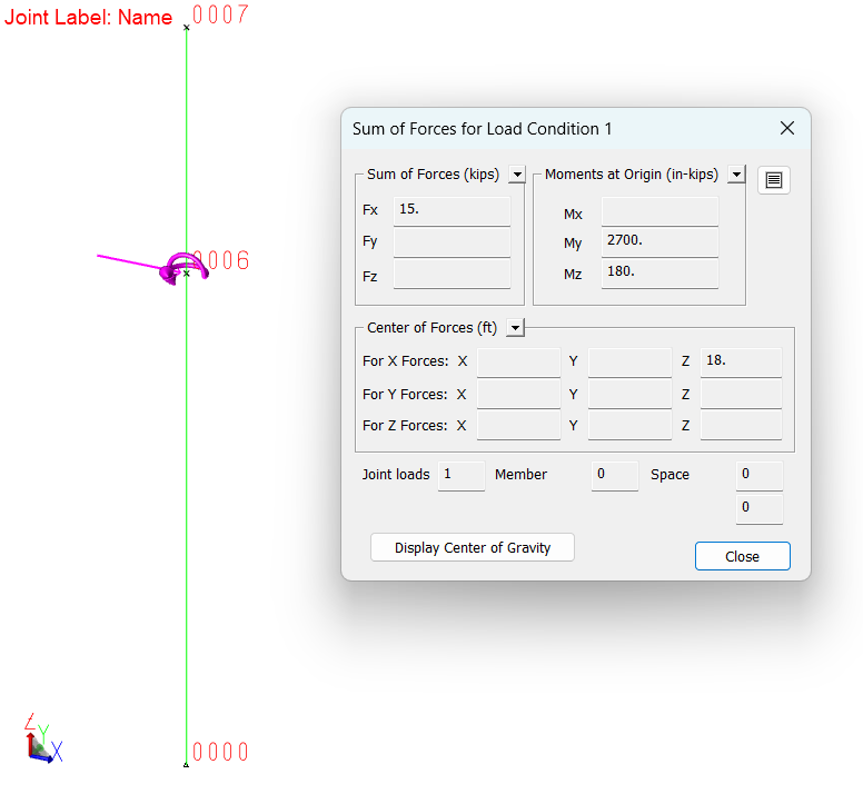

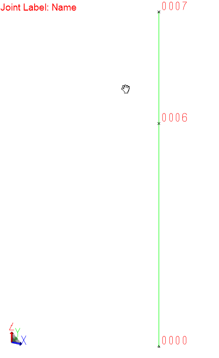

After the run, when the post view file is checked, the model looks like the following:
A screen shot of a gameDescription automatically generated
The dummy elements along with the dummy joints are no longer seen.
If the applied load is checked, it is found that the applied load is now transferred to the boundary joint, along with the corresponding moments due to eccentricity.
