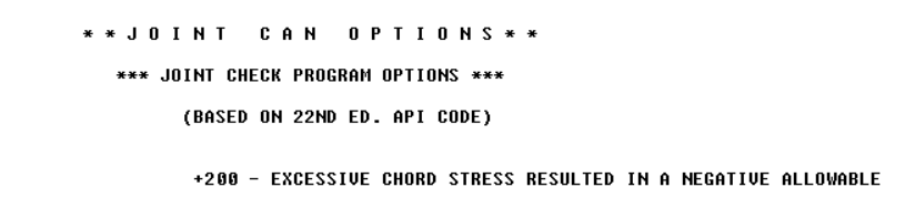

Say for example, in a listing file, you might get the following information.
A black text on a white backgroundAI-generated content may be incorrect.
Here, SACS wants you to check the chord stress. Your joint might be ok, but the actual chord stress is large.
So, anytime, you face the “200” UC in joint can, go to the listing file and see what it indicates.
