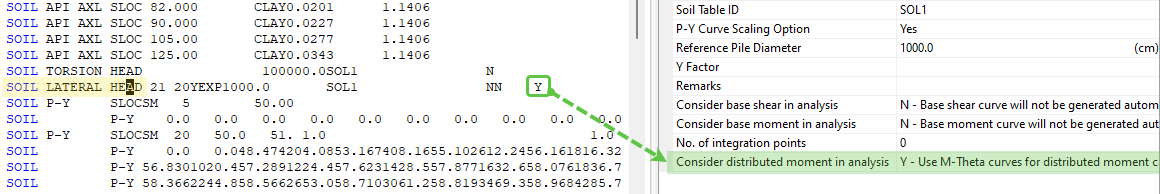

To use the PISA method, the option 'Y' - Use M-Theta curves for distributed moment calculation along the pile length, in column 67 of the SOIL LATERAL HEAD line has to be selected.

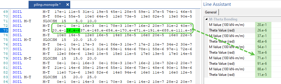

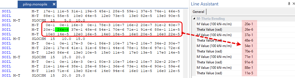

Example of incorrect input:
Example of correct input:
