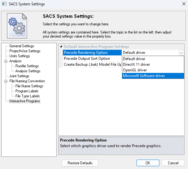

I am not able to see the model in precede. The same model when seen in another computer, works perfectly but when copied to the new environment the precede shows a blank page. However, the datagen in the new environment contains the model data.
R.
This sounds like a driver issue, especially if this is running off a virtual machine or a computer using onboard graphics. Try changing the rendering option under SACS Executive > Settings > Interactive Programs > Precede Rendering Option to “Microsoft Software Driver” and relaunch Precede. If it is a rendering issue, this option should fix the problem.
