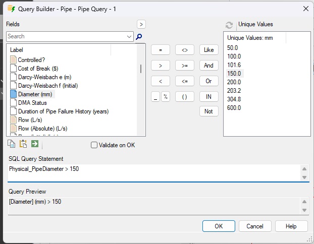

Improved query preview in Query Builder
The Query Builder has an improved Query Preview section, which will display a more meaningful preview of the query you are creating, rather than the name of the item from the SQLite database.
The Query Preview will display a more logical description of the query, while the SQL Query Preview will display the query using the name of the field in the database file.
