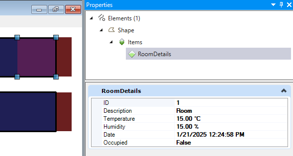

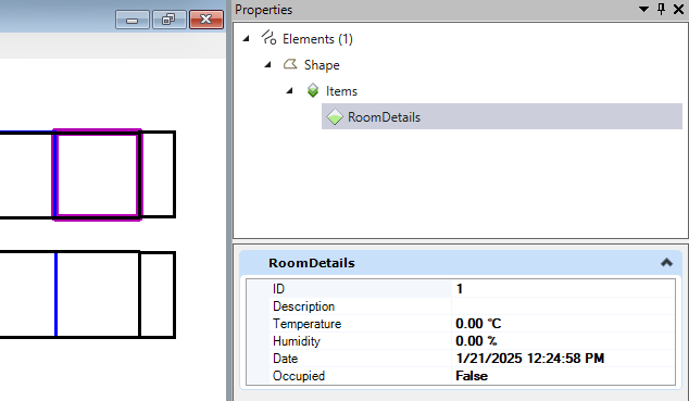

Item Type “RoomDetails” values are updated to all Shape elements as illustrated below.
Before
After

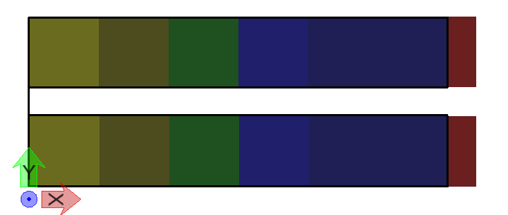

A display style is applied to add color to the Temperature values.
