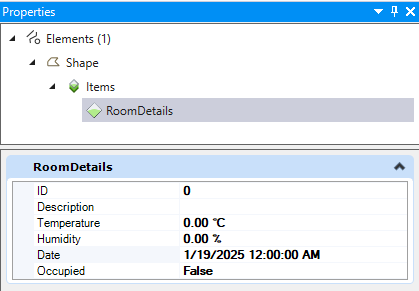

Item Type “RoomDetails” is attached to all Shape elements as illustrated below.
