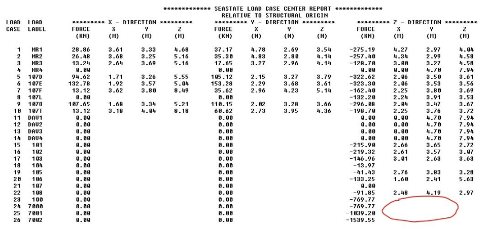

COG for Z directions not showing in "Seastate Load Case Center Report"
Question
The CoG value for load combination is not showing. Please advice how to solve this.

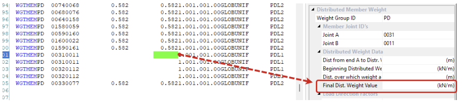

Check the weight input and make sure the Final distribution weight value is correctly defined.

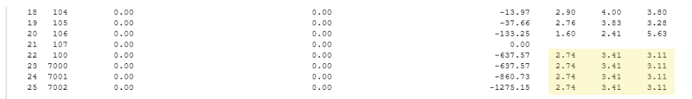

Result after correction:
