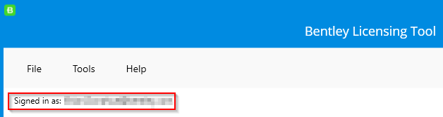

If you can sign into CONNECTION Client, this should be reflected in the Bentley licensing tool as well.
If named pipes are not functioning, the Bentley License Management Tool will not be aware that CONNECTION Client is Signed in, and will display a different message

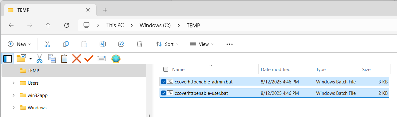

1 )  Download "ccoverhttpenable v3.zip", unzip the file to get "ccoverhttpenable-user.bat" and "ccoverhttpenable-admin.bat"

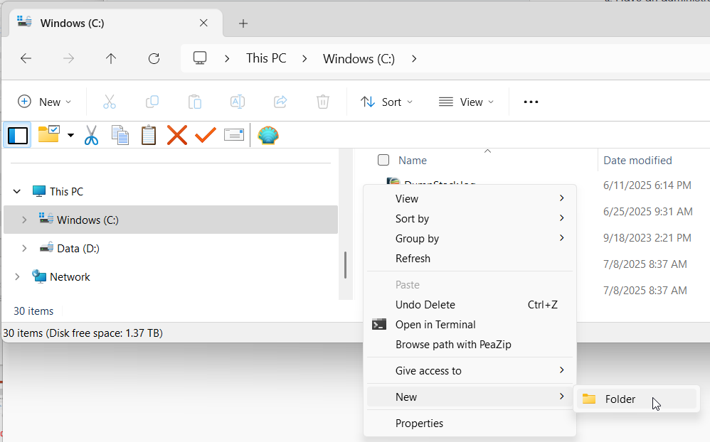

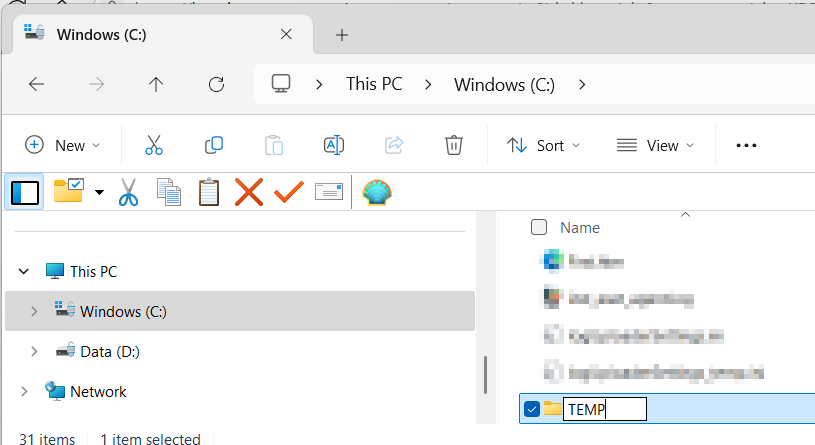

Note the directory you saved the files to, you will have to navigate to the directory in the command line. if you are unfamiliar with the Command Line, create a directory (below example is for a directory named TEMP) off the root of the C: drive and put the files there for ease -

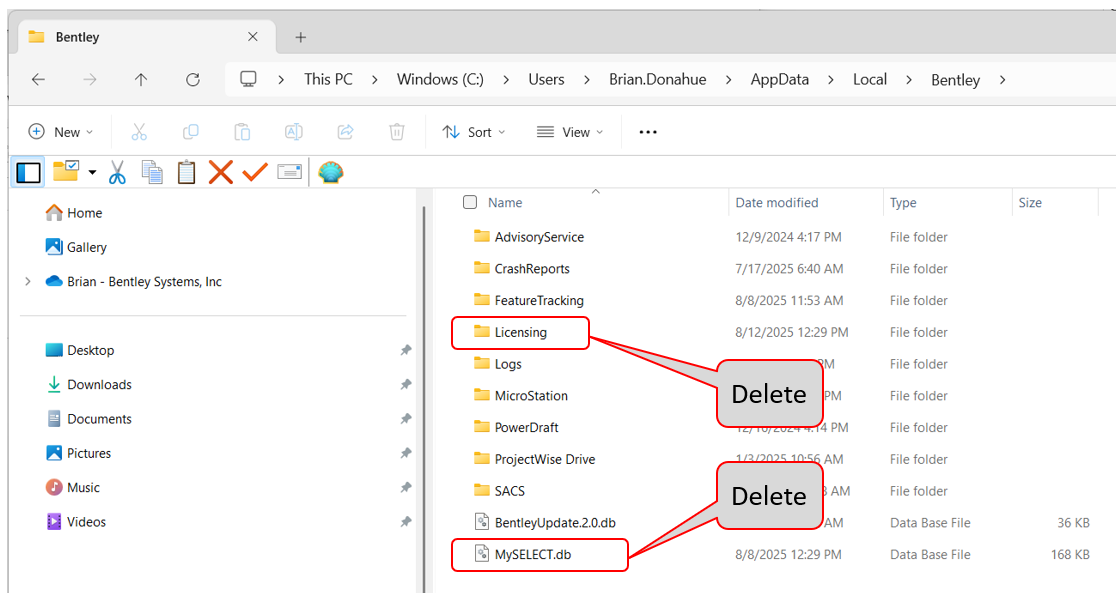

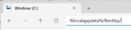

4)  Navigate to %localappdata%/Bentley/  (paste into address bar in Windows Explorer),
5)  Delete "MySELECT.db" and Delete "Licensing" folder (and all files within)

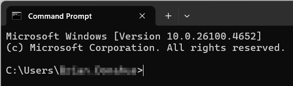

b) Sign in to windows as regular user, run CMD (Click the Start button, type "cmd" into the search bar, then click "Command Prompt".)
c) Navigate to the directory where you saved the bat files, using CD command
CD [/D] [drive:][path]   For instance - CD C:\TEMP

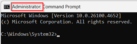

a) Run CMD as an Administrator (Click the Start button, type "cmd" into the search bar, then right-click "Command Prompt" and select "Run as Administrator.")
    • Click "Yes" if the Windows 10 User Account Control prompt appears
b) Navigate to the directory where you saved the bat files, using CD command
    1. CD [/D] [drive:][path]   For instance - CD C:\TEMP
c) Run Admin script in Admin CMD ccoverhttpenable-admin.bat <space>1 <enter> -  "ccoverhttpenable-admin.bat 1" (leave off the quotes)

8)  Login to CONNECTION Client
9)  Open Bentley License Tool, verify that Bentley License Tool has username displayed in upper left corner. If name doesn’t appear in Bentley License Tool , run CONNECTION  Client as Admin and try again.
