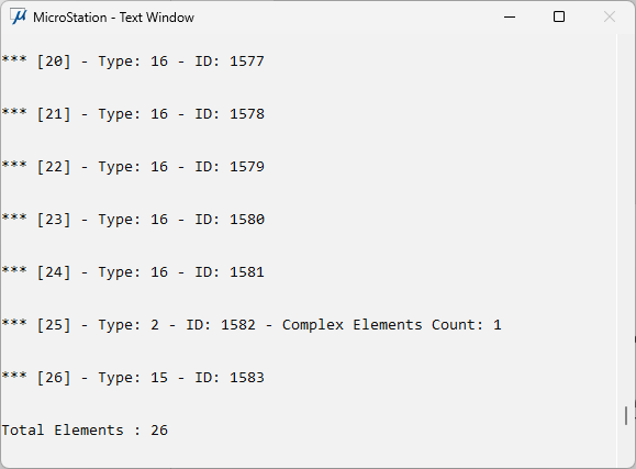

Run/Execute project
Load the project "ScanCellElements.py" from the Python Editor dialog and Run/Execute the python script.
The above python code, identifies a Cell element by its ID. Iterates through all child elements (via ChildElemIter), outputting their TYPE, ID, and the TOTAL NUMBER of child elements within the cell.
