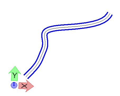

Welcome to the world of MicroStation Python! In this wiki, we'll explore how to search a Curve element by its unique identifier, Element ID and apply stroke and offset functions to it.
Curve Stroke and Offset in MicroStation with Python
To get started, refer to the Python Editor wiki for instructions on creating and loading a new Python project. Name your project "CurveOffset.py" and save it in a convenient location. Once created, open the project in your preferred code editor to begin writing your Python script.
Here is the complete script.

Run/Execute project
Load the project "CurveOffset.py" from the Python Editor dialog and Run/Execute the python script.
Curve element is located by ID and then stroke, offset operations are applied.
Run the script using the attached DGN file to verify its functionality.
