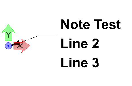

Load the project "NoteElement.py" from the Python Editor dialog and Run/Execute the python script.
Note element is created and placed into the DGN file.
This script offers a simple and efficient method for creating a Note element. Customize the script to suit your requirements and integrate into your workflows.
