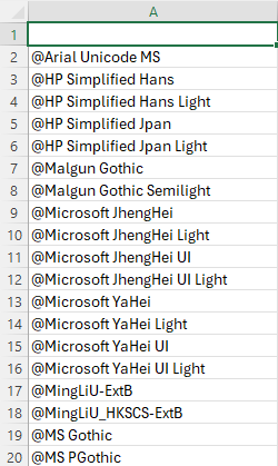

All available True Type Fonts are extracted and exported to a CSV file using the Pandas | DataFrame.
Font List
