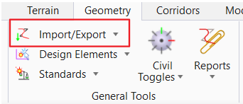

I keep getting "Unexpected Error Occurred. Command Exited. Error Details: Object reference not set to an instance of an object." when trying to run a Horizontal Geometry Report for this alignment. How to resolve?
Answer:
We found that exporting the alignment to xml and re-importing resolved this issue.
