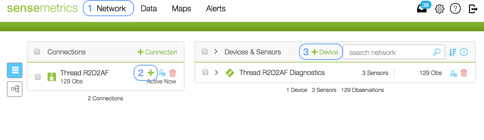

1. Navigate to the Network Module
2.  Press the  button directly on a THREAD to add a Device to it. If your THREAD does not appear here, you may still need to Add Your THREAD as a Connection.
3.  You may also add a device from the A green and blue textDescription automatically generated button in the Devices & Sensors Section

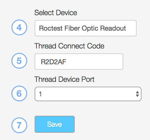

4.  Begin by typing in "Roctest Fiber Optic Readout" and select the name once it autocompletes in the search boxA close up of a logoDescription automatically generated
5.  Type in the Connect Code of the THREAD that the Device will be connected to. It will already be pre-filled if the  button on the THREAD was used.
6.  Next, select the THREAD communication port that the device is plugged into, Device 1 or 2.
7.  Press   A blue rectangle with white textDescription automatically generated  to write the settings

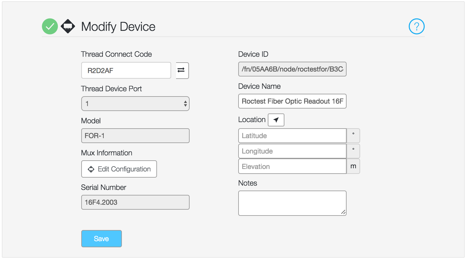

sensemetrics will automatically detect the Readout connected and will bring in serial number, number of channels and model number.
MUX Configuration
The Channels on the readout will now need to be configured to the specific fiber optic sensor you are using. Click the "Edit Configuration" button under Mux Information.
If you have exited device configuration, click back into the Roctest Fiber optic readout by finding it in the Devices & Sensors list on the right hand side of Network. This will open the Device configuration settings.

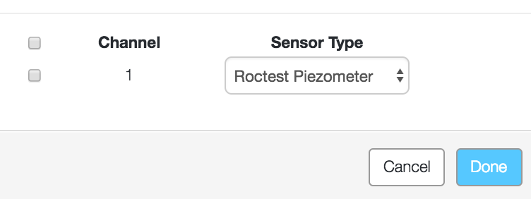

Select the type of fiber optic sensor that is on each channel.
Click "Done" when finished and make sure to click "Save" to write the settings.

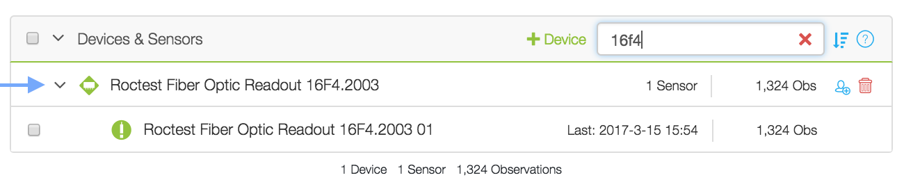

Once saved, the configured Fiber Optic sensors will populate beneath the Roctest Fiber Optic Readout Device and can be viewed by clicking the drop down arrow.
