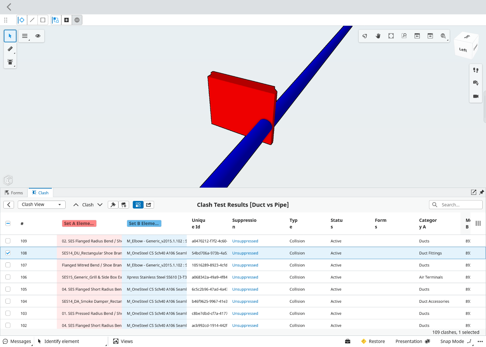

Organizing Results
When one or more clashes are selected, the iModel Viewer will show in Red elements corresponding to Set A and in Blue elements corresponding to Set B, the rest of the elements will be greyed out to make it easier to identify the clashes.

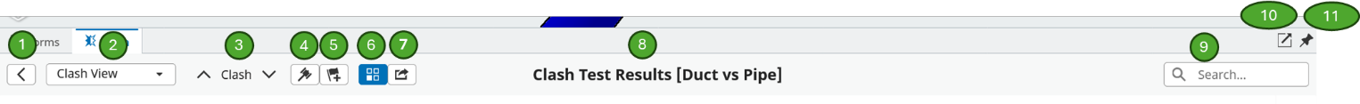

The tool bar at the top left corner of the panel will allow users to navigate between clashes, select all/none, etc.
1. Back (left) Chervon: Go back to Clash Tests.
2. Cluster/Clash Switch: Switch between Cluster grouped view and instance clash instances.
3. Previous/Next Clashes or Clusters: Navigate to the next or previous clash/cluster in the table and the 3D Model view.
4. Manual suppression: Allows users to manually suppress the selected clashes or clusters in the table.
5. Create Form: Creates a new form instance linked to the selected clashes or clusters.
6. Isolate: this isolates the selected clashes in the model view removing all other elements from the view.
7. Export to CSV: Allow users to export selected clash data including properties into a .CSV file format for download.
[Note: Only supported in Clash view, not Cluster view]
8. Name: displays the Clash Job/Test title.
9. Search: The searches all table values across all columns displayed.
10. Pop-out: This allows the Clash Widget to be popped out into a separate browser window that can be put on different screens/monitors.
11. Pin: enabling or disabling this will keep the widget on screen or it will auto-hide when not in use.
