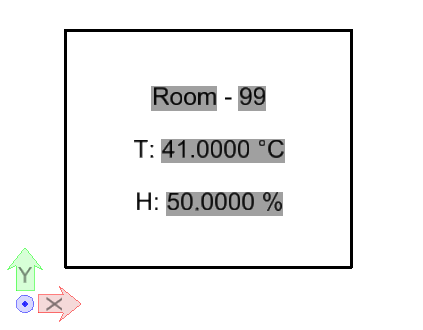

Run/Execute project
Load the project "CreateTextField.py" from the Python Editor dialog and Run/Execute the python script.
Text Fields are created and placed, from the Item Types attached to the Shape Element.
Run the script using the attached DGN file to verify its functionality.
