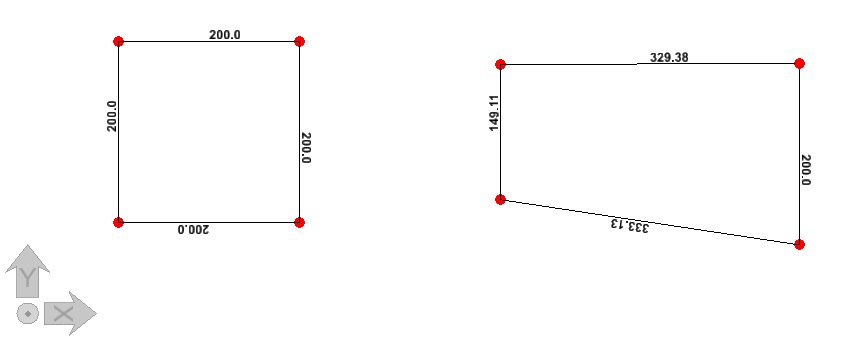

Create Interactive Placement Tool in MicroStation with Python
Let us dive into, creating an interactive placement tool. Refer to the Python Editor wiki to create and load a python project. Name your project as “PlaceALine.py” and save it to your preferred directory. Open the project in the editor for writing your Python script.

DgnPrimitiveTool: Dynamics
The _OnDynamicFrame (self, ev) function responds to a mouse move event. The parameter DgnButtonEvent ev is the button event which contains the button position/point.
This function implements the RedrawElems API to dynamically/temporarily draw the preview of the Line,  Dimension Text elements.

When a minimum of two points are available a Line element is created along with Dimension Text (length of the line) and both the elements are added to the Model.

Run/Execute project
Load the project “PlaceALine.py” from the Python Editor dialog and Run/Execute the python script.
Click on the screen to create Line elements with dimension texts and is added to your active MicroStation model. Experiment with different events such as Dynamics (mouse move), Reset button (mouse right click) to see how the application functions.
Note: To manage the dimension texts, modify the default Text Style settings such as Text Size, Offset.
Video:
This script provides a straightforward and efficient way to create line elements with dimensions interactively. Feel free to experiment with creating other 2D and 3D elements to meet your needs and seamlessly integrate them into your workflows.
