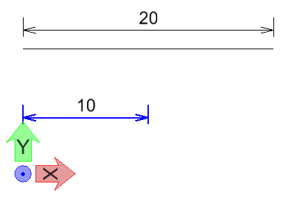

Create Associative Dimension in MicroStation with Python
Let us dive into, creating an associative dimension element. Refer to the Python Editor wiki to create and load a python project. Name your project as "CreateDimensionAssociative.py" and save it to your preferred directory. Open the project in the editor for writing your Python script.

The createDimension () function, takes Start Point, End Point, Height Offset Distance, Dimension Style, and Text Style as input arguments and creates a Dimension element. Here is a breakdown of what it does:
  1. Global Variables: used to access the active model, DGN model, DGN file, and UOR per storage unit is declared.
  2. Initialize Dimension Properties: Rotation matrix, symbology and direction formatter for the dimension element.
  3. Create Dimension Data: Initializes an instance of IDimCreateData and then sets it up with the provided dimension style, text style, rotation matrix, symbology, and direction formatter using the DimCreateData class.
  4. Dimension Handle: Set a writeable "handle" to a Dimension element using EditElementHandle ().
  5. Create Dimension Element: passing Dimension Data, Dimension Type as input to function DimensionHandler.CreateDimensionElement ().
  6. Insert Points into Dimension Element: Get a Handler and inserts the start, end points into the Dimension element using dimEdit.InsertPoint ().
  7. Apply Properties: Set Height Offset to the Dimension element, using dimEdit.SetHeight ().
  8. Add Dimension Element to Model: The newly created Dimension element is added to the Model dim_eeh.AddToModel (). The script includes error checking to ensure that the Dimension element is successfully added to the model.

The createDimensionWithAssocPoint () function, takes Start Point, End Point, Height Offset Distance, Dimension Style, and Text Style as input arguments and creates a Linear root element and associates a Dimension element to the Linear element. Here is a breakdown of what it does:
Linear Root Element:
  2. Create Line Element: Line element is created using the LineHandler.CreateLineElement () function. This function takes several parameters, that includes Line element handle, Line segments constituting Start and End point coordinates and the Model to which the Line element should be added.
  3. Line Orientation: Retrieve orientation of the line element using  GetOrientation () function.
  1. Initialize Dimension Properties: Rotation matrix, symbology and direction formatter for the dimension element.
  1. Create Dimension Data: Initializes an instance of IDimCreateData and then sets it up, with the provided dimension style, text style, rotation matrix, symbology, and direction formatter using the DimCreateData class.
  2. Dimension Handle: Set a writeable "handle" to a Dimension element using EditElementHandle ().
  3. Create Dimension Element: passing Dimension Data, Dimension Type as input to function DimensionHandler.CreateDimensionElement ().
Dimension Associative Points:
  1. AssociativePoint InitKeypoint: Initialize the data in the associative point for an association that represents a point on a linear element using AssociativePoint.InitKeypoint () function.
  2. AssociativePoint SetRoot: Complete setup of a new associative point by setting the target/root element for the dependency by a pair of element ids using AssociativePoint.SetRoot () function.
  3. Insert Points into Dimension Element: Get a Handler and inserts the start, end and associative points into the Dimension element using dimEdit.InsertPoint ().
  4. Apply Properties: Set Height Offset, Rotation to the Dimension element.
  5. Add Dimension Element to Model: The newly created Dimension element is added to the Model dim_eeh.AddToModel ().

Run/Execute project
Load the project "CreateDimensionAssociative.py" from the Python Editor dialog and Run/Execute the python script.
Dimension element is created adding associative point dependencies to a line element and added into your active MicroStation model.
Altering the line points/coordinates, automatically updates the associated dimension.
This script offers a simple and efficient method for creating a dimension element with associative point dependencies added to a line element. Customize the script to suit your requirements and integrate into your workflows.
Happy coding!
