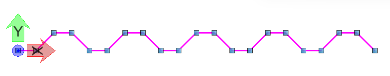

Load the project “SearchElementById.py” from the Python Editor dialog and Run/Execute the python script.

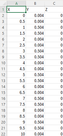

Linear element with element id 1154 present in the active Model is identified and added to the Selection Set.
After identifying the linear element, its coordinates are extracted and exported to a CSV file using the Pandas | DataFrame.
This script provides a straightforward way to search for an element by its ID and export its coordinates to a CSV file.
