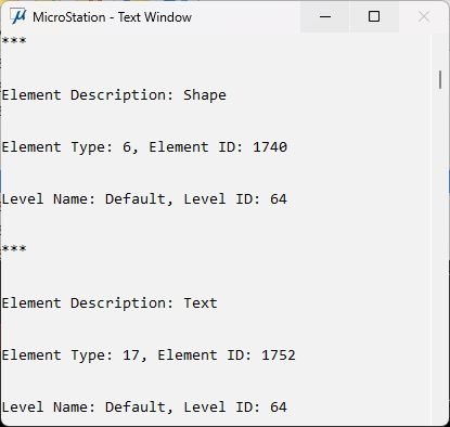

Run/Execute project

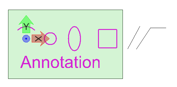

Load the project “FenceElements.py” from the Python Editor dialog, place a Fence covering elements from the active model, select the required Fence Type, Mode and Run/Execute the python script.
Elements matching the Fence criteria are highlighted and their information (Description, Type, Id, Level Name, Level Id), is displayed in the MicroStation Text window.
