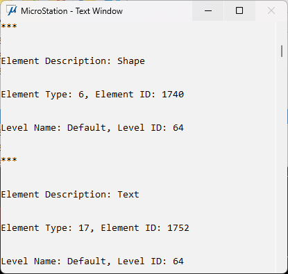

Run/Execute project
Load the project "SelectionSet.py" from the Python Editor dialog, select some elements from the active model and Run/Execute the python script.
Selected element information (Description, Type, Id, Level Name, Level Id), is displayed in the MicroStation Text window.
