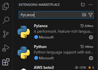

  3. Search for PyLance: In the Extensions view, type "PyLance" in the search bar at the top.
  1. Install PyLance: Find the PyLance extension from Microsoft in the search results and click the "Install" button.
