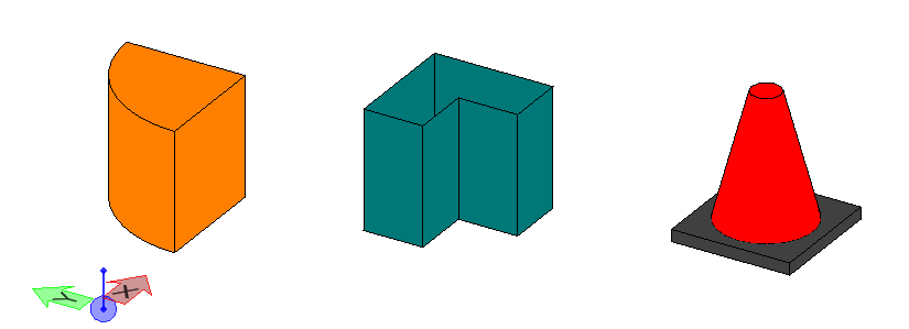

Let us dive into creating 3D geometric elements such as Solid, Surface, Slab, and Cone using Python. Refer to the Python Editor wiki to create and load a python project. Name your project as "Create3DElements.py" and save it to your preferred directory. Open the project in the editor for writing your Python script.

Create a Solid Element
The CreateASolidElement() function takes a base point as input, which defines the initial location of the Solid element. Let us walk through the steps to create a Solid element. The script includes error checking to ensure the Solid element is successfully created and added to the model.
  1. Create a closed shape element using an Arc and a Line String element.
  2. Add the closed shape to a Chain element using the ChainHeaderHandler.CreateChainHeaderElement() function.
  3. Convert the Chain element to a solid body using the SolidUtil.Convert.ElementToBody() function.
  4. Thicken the Solid element using the SolidUtil.Modify.ThickenSheet() function.
  5. Convert the solid body to a solid element using the SolidUtil.Convert.BodyToElement() function.
  6. Apply a Color property (symbology) to the Solid element and add it to the model using the AddToModel() function.

Create a Surface Element
The CreateASurfaceElement() function takes a base point as input, which defines the initial location of the Surface element. Let us walk through the steps to create a Surface element. The script includes error checking to ensure the Surface element is successfully created and added to the model.
  1. Set up the coordinates for the Line String element using the base point and additional points.
  2. Store the Line String coordinates to a DPoint3d array.
  3. Create the Line String element using the LineStringHandler.CreateLineStringElement() function.
  4. Set up the extrude point and vector for extrusion using DVec3d() function.
  5. Create the Surface element using the SurfaceHandler.CreateProjectionElement() function.
  6. Apply a Color property (symbology) to the Surface element and add it to the model using the AddToModel() function.

Create a Slab Element
The createASlabElement() function takes a base point as input, which defines the initial location of the Slab element. Let us walk through the steps to create a Slab element. The script includes error checking to ensure the Slab element is successfully created and added to the model.
  1. Define the coordinates for the shape element using a base point and an offset.
  2. Store the shape coordinates in an DPoint3d array.
  3. Create the Shape element using the  ShapeHandler.CreateShapeElement() function.
  4. Convert the Shape element to a solid body using the SolidUtil.Convert.ElementToBody() function.
  5. Thicken the solid body using the SolidUtil.Modify.ThickenSheet() function.
  6. Convert the solid body to a solid element using the SolidUtil.Convert.BodyToElement() function.
  7. Apply a Color property (symbology) to the Slab element and add it to the model using the AddToModel() function.

Create a Cone Element
The CreateAConeElement() function takes a base point as input, which defines the initial location of the Cone element. Let us walk through the steps to create a Cone element. The script includes error checking to ensure the Cone element is successfully created and added to the model.
  1. Set up the coordinates for the top and base point of the cone element.
  2. Create the Cone element using the ConeHandler.CreateConeElement() function.
  3. Apply a Color property (symbology) to the Cone element and add it to the model using the AddToModel() function.

Run/Execute project
Select project "Create3DElements.py" from the Python Editor dialog and Run/Execute the python script.
Voila! 3D elements are successfully created and added to your active MicroStation model.
A blue box with black outlineDescription automatically generated
Explore the examples, documentation and challenge yourself to create other 3D geometries.
