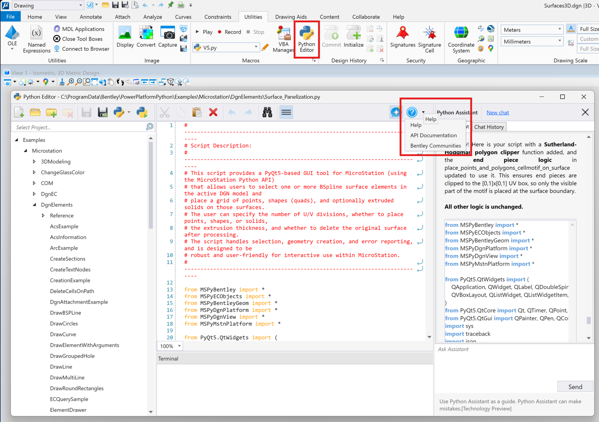

MicroStation includes a user interface to manage, run, edit, and seek guidance via the Python assistant for Python scripting. Python serves as an API (Application Programming Interface) to the back end of MicroStation and due of the reasons above, makes the logical choice to make this available, alongside VBA, and the software development kit.
How can I learn to use this feature?
The basics of using and developing Python scripts can be found in the MicroStation Help document under the "Python Editor" section via the ribbon. This can also be accessed via the Python Editor in MicroStation.
The other options available from the drop down includes a link to this page, and a link to the API documentation.
