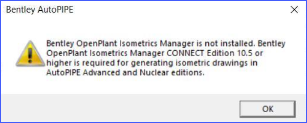

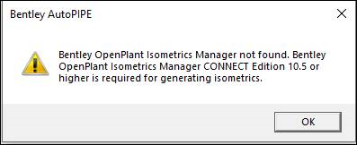

The following appears in AutoPIPE when trying to create Stress Isometric:
Bentley OpenPLANT Isometrics Manager not found, Bentley OpenPlant Isometrics Manager CONNECT Edition 10.5 or higher is required for generating isometrics.
OK
Bentley OpenPLANT Isometrics Manager is not installed. Bentley OpenPlant Isometrics Manager CONNECT Edition 10.5 or higher is required for generating isometrics in AutoPIPE Advanced and Nuclear editions.
OK

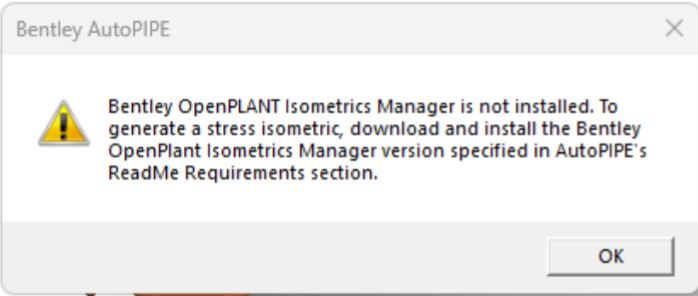

Bentley OpenPLANT Isometrics Manager is not installed. To
generate a stress isometric, download and install Bentley
OpenPlant isometric Manager version specified in AutoPIPE's
Readme Requirements section.
OK
Why and How to resolve?
Please read the dialog message again!
In this case, the message clearly states that OPIM v.10.05 or higher must be installed in order to create an Isometric. Confirm that the correct version of the OPIM is installed on the computer. See WIKI here for different methods of confirming your installed software versions (suggest #3).
