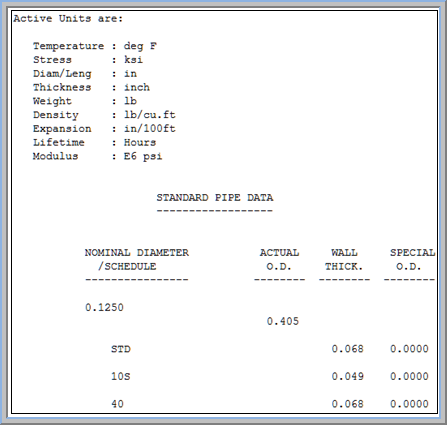

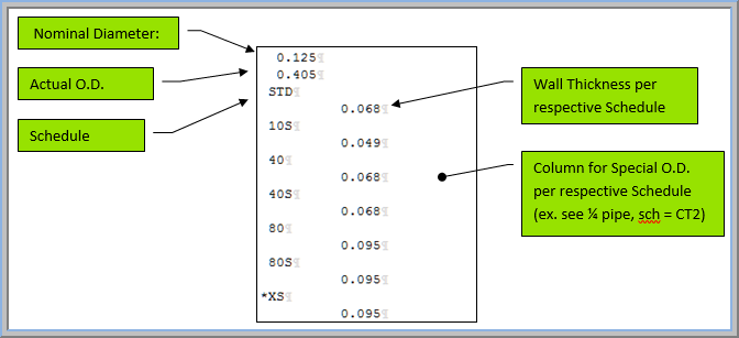

1. STANDARD PIPE DATA Section
This section contains general information about pipe sizes (i.e. Nominal diameter, Actual OD) and tabulated data (i.e. Schedule, Wall Thickness and Special OD) for each entry. A scan of this table can be viewed with the following instructions:
1. Start AutoPIPE, and select Tool> Library>
Press OK button
2. AutoPIPE Viewer appears with the AUTOPIPE.lib Pipe section, excerpt shown below:
3. The AUTOPIPE.SRC file can be opened with any text editor. The "STANDARD PIPE DATA " starts on line 2 (or perform a search "PIPE") and then scroll down below  the table programming lines to see the entries. Excerpt from the AUTOPIPE "SRC" file (line 18) is shown below with explanations of each value:
Note: Corresponding units are visible at the top of the Library scan, shown above

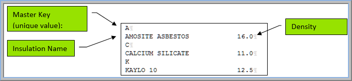

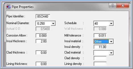

2. INSULATION MATERIALS Section
This section contains general information about pipe insulation material (i.e. Material and Density). The only method of viewing this information from within the application is thru the pipe properties dialog screen using the following procedure:
1. With a model open, Insert / modify a pipe property to view this dialog
2. Select the down arrow to view all the existing insulation materials available in this particular library; excerpt shown below:
3. The AUTOPIPE.SRC file can be opened with any text editor. The "INSULATION MATERIALS " starts on line 722 (or perform a search "INSL") and then scroll down below  the table programming lines to see the entries. Excerpt from the AUTOPIPE "SRC" file (line 737) is shown below with explanations of each value:

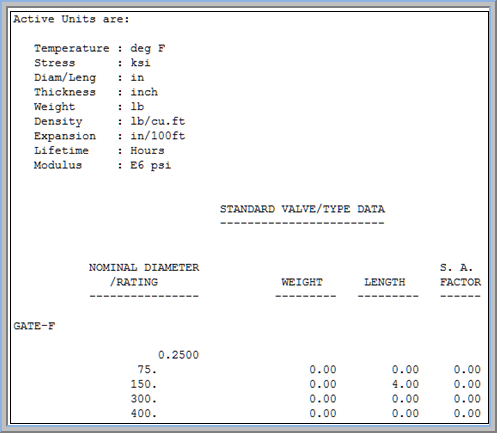

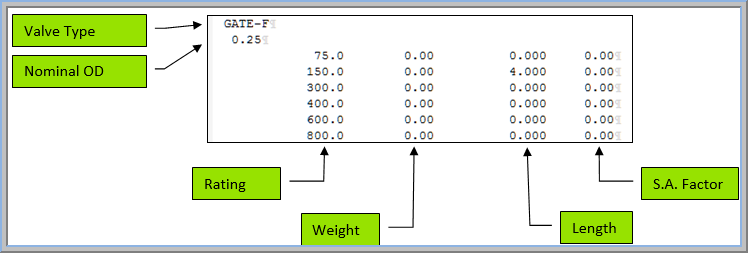

3. STANDARD VALVE/TYPE DATA Section
This section contains general information about valves (i.e. Type, Nominal dia) and tabulated data (i.e. Rating, Weight, Length, S.A. Factor) for each entry. A scan of this table can be viewed with the following instructions:
Press OK button
2. AutoPIPE Viewer appears with the AUTOPIPE.lib Valve section, excerpt shown below:
3. The AUTOPIPE.SRC file can be opened with any text editor. The "STANDARD VALVE/TYPE DATA " starts on line 761 (or perform a search "VLV1") and then scroll down below the table programming lines to see the entries. Excerpt from the AUTOPIPE "SRC" file (line 810) is shown below with explanations of each value:
Note: Corresponding units are visable at the top of the Library scan, shown above

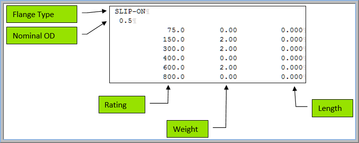

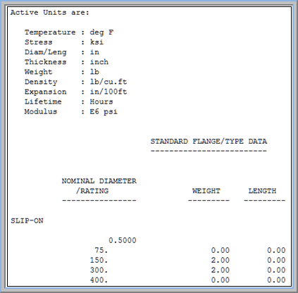

4. STANDARD FLANGE/TYPE DATA Section
This section contains general information about Flanges (i.e. Type, Nominal dia) and tabulated data (i.e. Rating, Weight, Length) for each entry. A scan of this table can be viewed with the following instructions:
Press OK button
2. AutoPIPE Viewer appears with the AUTOPIPE.lib Flange A section, excerpt shown below:
3. The AUTOPIPE.SRC file can be opened with any text editor. The "STANDARD FLANGE/TYPE DATA " starts on line 2369 (or perform a search "FLTP") and then scroll down below the table programming lines to see the entries. Excerpt from the AUTOPIPE "SRC" file (line 2409) is shown below with explanations of each value:
Notes :
1. Corresponding units are visible at the top of the Library scan, shown above.
2. Because an AutoPIPE flange is modeled as a single point, Length = 0.000 (always).

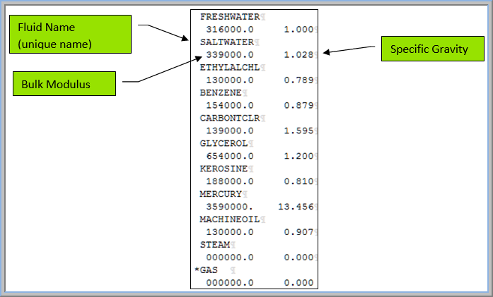

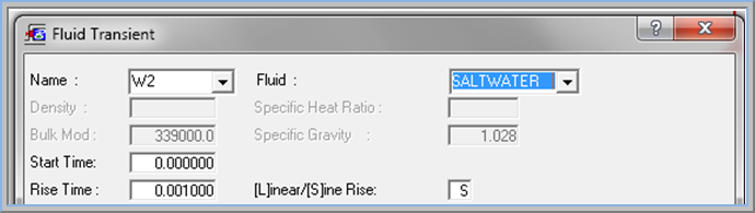

6. FLUID PROPERTIES - BULK MODULUS AND SP. GR. Data Section
This section contains general information about fluids used in fluid transient analysis (i.e. Fluid Name, Bulk modulus, Specific gravity). The only method of viewing this information from within the application is thru the Fluid Transient dialog screen using the following procedure:
1. With a model open, select Load> Fluid Transient… to view this dialog
2. Select the down arrow to view all the existing fluids available in this particular library; excerpt shown below:
Note: move slider down to view entire listing
3. The AUTOPIPE.SRC file can be opened with any text editor. The "FLUID PROPERTIES - BULK MODULUS AND SP. GR. Data " starts on line 722 (or perform a search "INSL") and then scroll down below the table programming lines to see the entries. Excerpt from the AUTOPIPE "SRC" file (line 737) is shown below with explanations of each value:

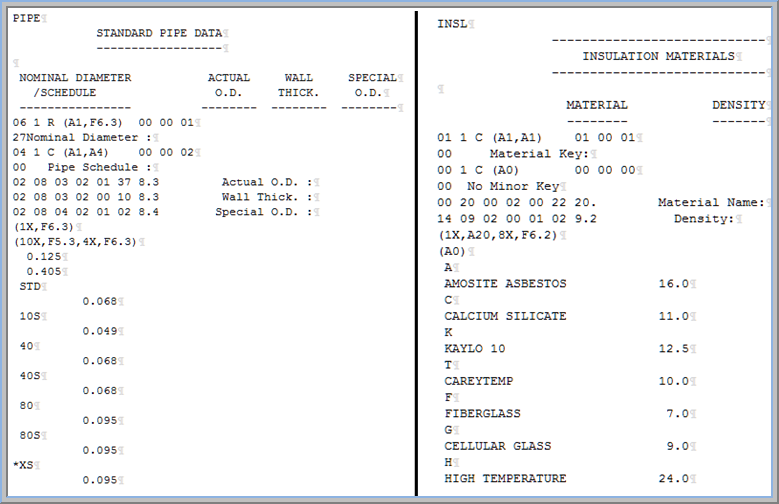

Modifying the SRC file
As indicated above, the SRC file can be opened by any text editor program. Recommend using a text editor that displays the current row and column location will be a great benefit (i.e. Ultra Edit, Notepad++, etc..) in maintaining column alignment and table format.
AutoPIPE.SRC library is broken into 6 sections where each of these sections starts with lines of table programming information, followed by detailed data on individual data available when selecting this library in AutoPIPE.
Example: shown below is the PIPE section (left) & INSULATION section (right) with column headers, followed by table programming lines, and the first entry (1/8 dia pipe) / (Asbestos), respectively.
Note:
The last entry in each section starts with an "*" symbol before the data. This "*" signifies the last entry in each grouping / section and is very import that it only occurs once.
Example 1:
Standard Pipe Data, "*" occurs after the last Nominal pipe size schedule (i.e Line 32, 50, 66, etc..) to signify the last schedule for each pipe size, and again at the last pipe size 36" (line 708) to signify the last entry in the section before Insulation Material.
Example 2:
Insulation Material, "*" only occurs once (line 759) to signify the last entry of insulation names before the valve data section.

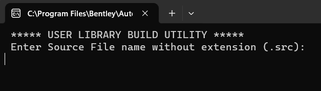

13. Open AutoPIPE's installation folder and search for program called: "build.exe", copy this program into the same folder where the modified SRC file is located.
14. Run the program "build.exe" (ex. double click the file, from the CMD line, etc..) and the following will appear:
15. Enter name of new SRC file without the extension,
16. IF the file is correctly formatted, a new file will be created in the same folder.
