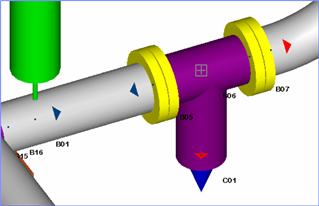

1. First model the piping component - see WIKI here for suggestion
2. Zoom Into the rigid pipe that represents the Piping component.
3. In this case, model the steel connected to the piping component. But first, add location for steel to be connected on piping component.
a. Convert point (ex. B06) to Tee
b. Insert pipe vertically down as needed.
c. Insert Rigid properties over range, Do not "Include weight", but include "Include Thermal Expansion"
Note the weight is already accounted for in the modeling approach of the piping component WIKI mentioned above, concentrated weight.
d. Insert Rigid Beam or Rigid Pipe member from the end of the vertical pipe to all 3 locations on the outside surface of the vessel.
Note:
i. For aesthetic only, suggest that the new beam or pipe property using a smaller section, ex. 2" pipe round
ii. Insert all 3 beams / pipes in one direction, then select and rotate beam / pipe to correct orientation
iii. If using a Rigid Pipe, enable Include thermal Expansion, and disable Include weight.
4. Insert new Beam section property for Steel supporting piping components, (ex. 2" angle), make sure to select the correct Material name or enter in the correct material properties.
5. Insert beam supports at each of the 3 surface locations, length = to the concrete floor. Adjust beam settings as needed to rotate orientation of vertical angle with respect to the piping component.
6. Since Steel is embedded into the concrete, assume that it is rigidly connected to the floor, insert rigid anchors at the end of vertical steel support
7. Insert pipe length to represent the cap at the bottom of the component.
8. Insert new pipe properties to represent pipe out the bottom of the component
9. Model new piping as needed from bottom of component.
10. Done!!!
