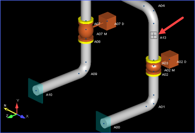

How to know what the local axes direction at a pipe node point in AutoPIPE?
Quick what is the local X-Y-Z direction at node point A13?
Are you sure or are you guessing?
Easy, use AutoPIPE new feature command, Local Axes (View > Display Axes > Local Axes > Local Axes).
Now we know for sure which direction is local X, Local Y, and local Z
