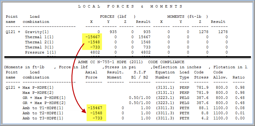

Item #2:
The axial force in code compliance is taken from the axial force evaluated during analysis of the model.
AutoPIPE thermal expansion is calculated using the equation found in the link here.

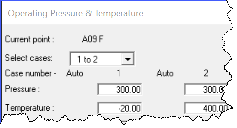

Item #3:
Question: are the pressures in gauge or absolute value?
Answer: Open AutoPIPE model, select a pipe run, open Operating Pressure & Temperature dialog,
The pressure entered in AutoPIPE are in gauge pressure (not atmospheric).
