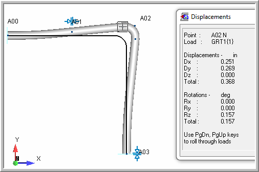

Gr+T1: No cut short is applied:

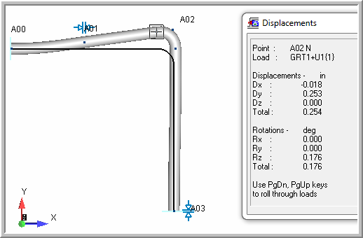

Gr+T1+U1: cut short is applied to the horizontal pipe run only:

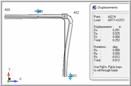

Gr+T1+U2: cut short is applied to the vertical pipe run only:

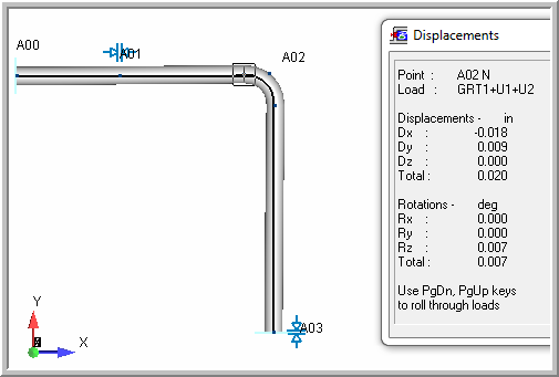

Gr+T1+U1+U2: cut short is applied to both the vertical and horizontal pipe runs:

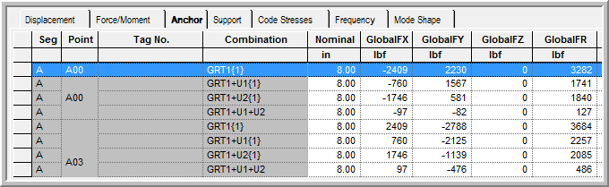

Notice the affect it has on the anchors for the respective load cases,
Conclusion, cut short does provide a reduction in anchor loads when correctly applied.
