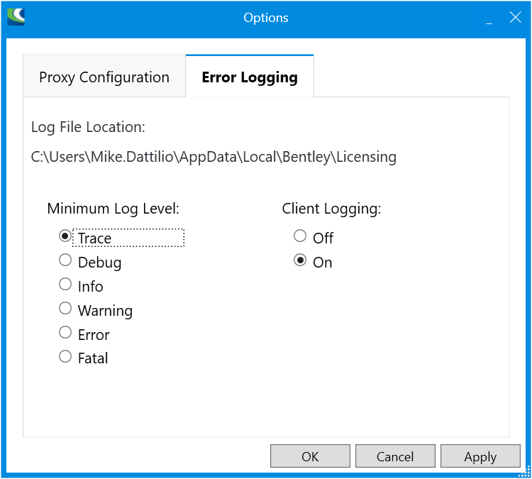

First enable the feature to allow logging, Open BLT by pressings "Win key + S" to open the search bar for windows, type "Bentley Licensing Tool", select app at the top in the listing provided, left mouse click on Open
Next, select Tools> Options> after the dialog opens select the Error Logging tab and enable the Client Logging ON radio button. Press Apply and close dialog.

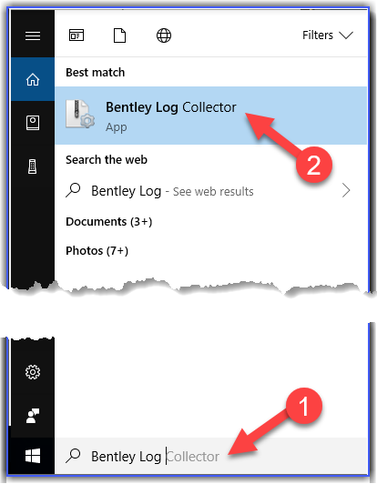

Option #2:
1. Select Windows Start
2. Type "Bentley Log Collector" and select the application shortcut to start the software as seen below:

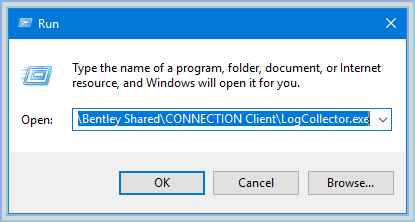

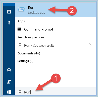

Option #3:
Type "Run" in search bar and select the "Run" application
 Type "%CommonProgramFiles%\Bentley Shared\CONNECTION Client\LogCollector.exe"
Press OK to continue.

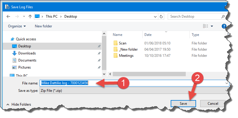

Step 3:
Provide a log file name and  location to save the log files, Suggest the "user name - SR number" and save to the Desktop
Press Save button to continue
