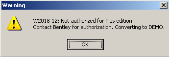

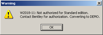

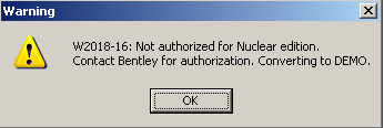

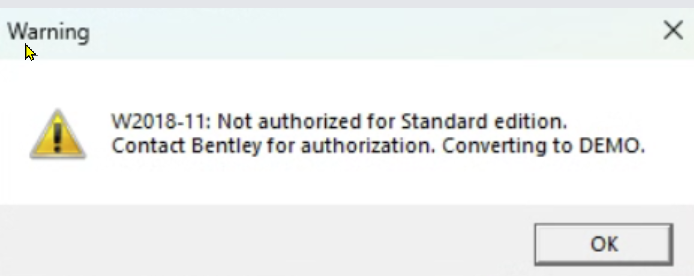

The following appears when starting AutoPIPE
Warning
 W2018-11: Not authorized for Standard edition.
 Contact Bentley for authorization. Converting to DEMO.
OK
Warning
 W2018-12: Not authorized for Plus edition.
OK
Warning
 W2018-16: Not authorized for Nuclear edition.
OK
