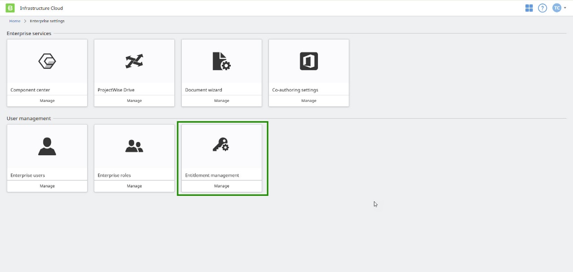

Entitlements are granted/assigned at the Enterprise Level which can be accessed through Enterprise Settings – Entitlement Management.

Before you start adding participants to Bentley Infrastructure Cloud projects, the Best Practice is to configure entitlements at the Enterprise Entitlement Management.
