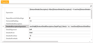

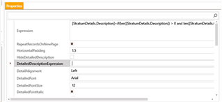

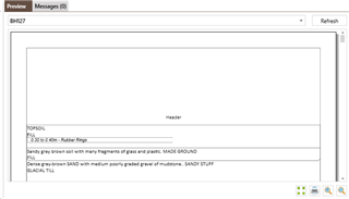

In Template Studio it is possible to edit the text that appears next to the detail description texts that appear next to the main geological descriptions. By default, the detail description will be plotted with no further information. This can be changed through the use of an expression.
To do this you will need to edit the expression that appears next to the 'DetailDescriptionExpression' in Template Studio.
Process
Further Information
The above expression is used to show the depths of the detailed information before the description. This can be adjusted to show further information as necessary including ground level etc.
