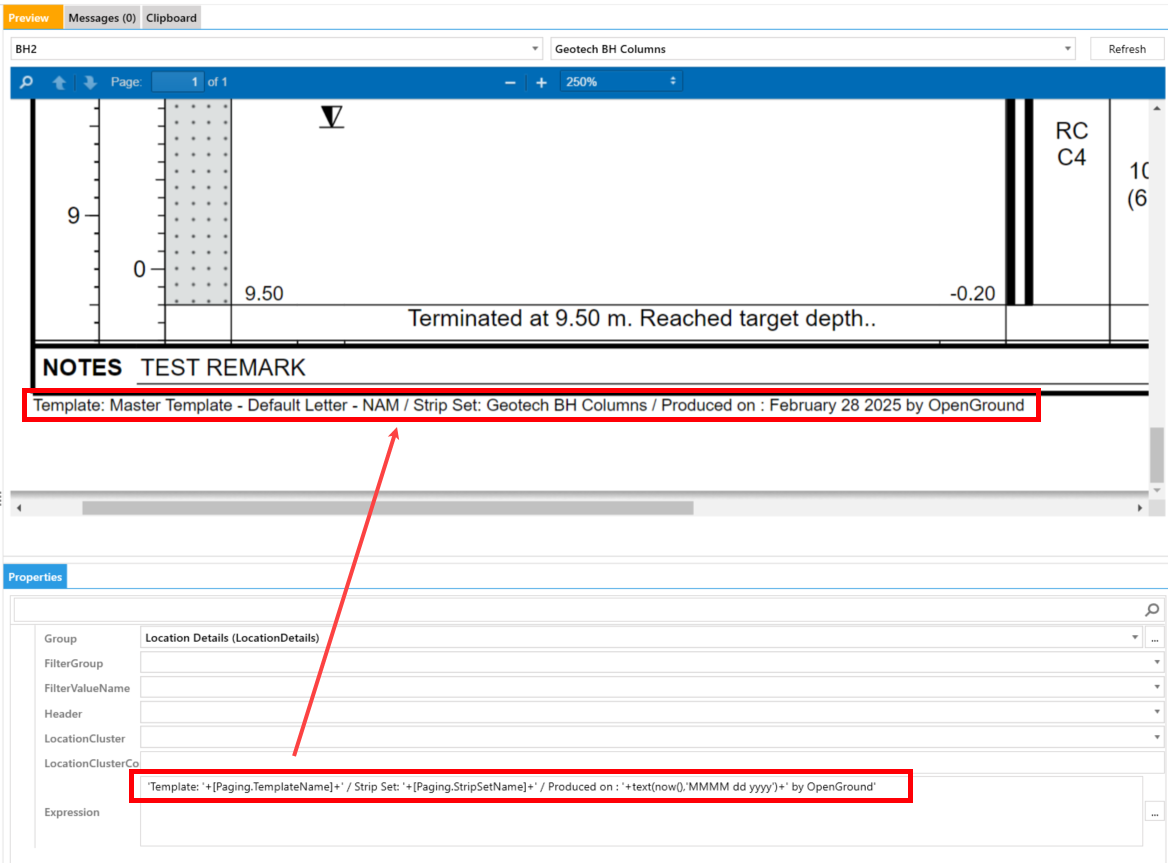

There are many uses for Run Time Functions, but one example would be to add a "tracking code", such as in the footer area of a report. For example, the expression below could be used on a Master Template:
'Template: '+[Paging.TemplateName]+' / Strip Set: '+[Paging.StripSetName]+' / Produced on : '+text(now(),'MMMM dd yyyy')+' by OpenGround'
