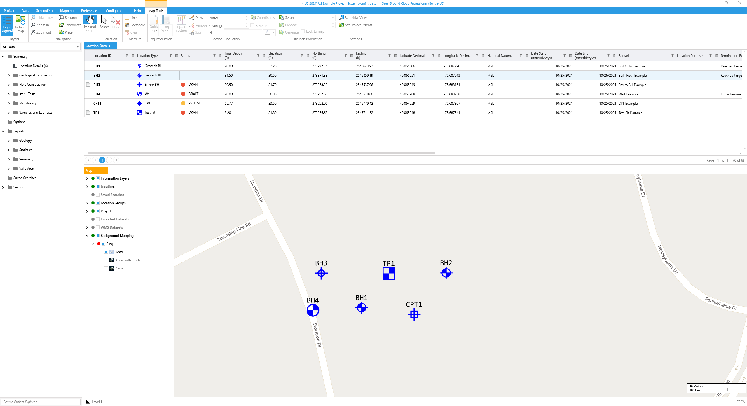

Location Details Grid
The Location Details Grid displays both:
This dual-format support allows users to manage and view both coordinate types in one place.

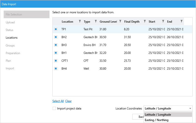

Importing Coordinate Data
Coordinate Format Selection
During data import:
Example: Importing Lat/Long Data
  1. Prepare a CSV file with Lat/Long values.
  2. Use the import wizard to select Lat/Long as the coordinate format.

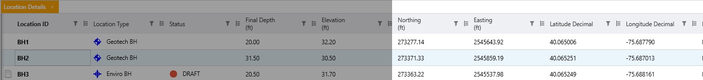

  3. OpenGround calculates and displays the corresponding E/N values after import.
  4. Locations are displayed on the map.
Lat/Long location coordinates chosen.
E/N values are now displayed and locations can be viewed on the map.

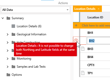

4.1 Automatic Synchronization
Note:It is only possible to edit E/N or Lat/Long values and you will not be able to edit E and Long, N and Lat or E/N and Lat/Long at the same time. If attempted a validation error message will be displayed.

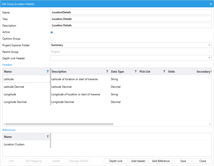

Latitude and Longitude Field Types
OpenGround includes two types of Lat/Long fields:
Field Type Description Conversion Supported
Latitude / Longitude String fields for text input (e.g., Degrees Minutes Seconds format) ❌ No
Latitude Decimal / Longitude Decimal Numeric fields for decimal values ✅ Yes
Important: Coordinate conversion only works with Decimal fields. If conversion isn’t functioning, check your configuration pack to ensure the correct headers are active.
